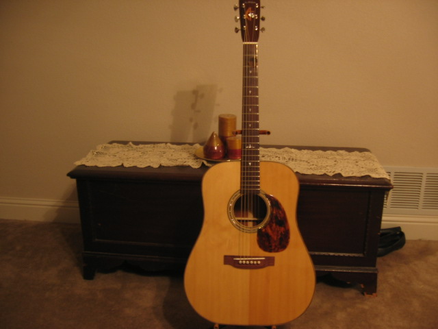

Here we finally go. The unveiling of #1. The whole reason I started setting up shop in the first place and the first thing I've ever built with wood that didn't require nails or screws . Seriously, until I started this my hands had never held a plane or wood chisel. Even though I put my name on the headstock, think of this as the guitar y'all built. Never could have done it without you guys!

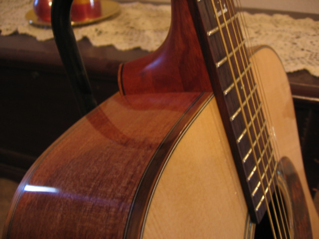

Here's the scoop: Honduran mahogany, SITKA, BLUEGRASS DREAD! There, I said it and I'm not taking it back ! Built from scratch from the Stew Mac herringbone plan with a few deviations. Namely no popscicle brace (replaced with Proulx style neck bracing), a couple of minor liberties taken with bracing, drop-in through saddle (also stolen - I mean, borrowed - from Mario. Thanks! Oh, wait...hey Mario, can I borrow your saddle design? ) now glued in after the bridge crack fiasco. I'll replace this soon. Bone nut and saddle, slotted and ramped MadRose belly bridge (and fingerboard), small maple bridge plate, oak bindings, nitro finish, HHG used throughout. Figgered if I was gonna learn this stuff, I may as well start out right then I won't have to relearn later!
Some more firsts for me:
1. First inlay
2. First bound fretboard (bound w/cutoff strips from the fretboard, unbound look but those ugly fret ends are covered up)
3. First mitered purfling
The good news is I made all my mistakes on this one, so the next one will have to be perfect!
I'll try to get better pictures later. I ran the batteries out in my camera trying to get some good ones under the size limit and have to let 'em recharge.
Oh, and how's it sound? Some seriously strong bass going on here. Loud and rumbly, but crystal clear. The trebles are already coming around pretty nicely, too, and becoming much more balanced the longer I play it. I can't wait to get some break-in time on this baby! She'll get her public unveiling Friday at a local bluegrass jam.
This has been a blast! Wish I could say I'm starting on #2, but we're buying another house, so guess what I'll be doing the next few weeks. First thing when I get settled is to start on a shop. #2 is gonna be a rosewood OM (I think)as a gift for a friend in GA I used to play in a band with doing a lot of local music ministries. He doesn't know about it yet.

Beautiful guitar. Nice work. Wouldn't be able to tell its your first at all.

Wow, beautiful guitar! The mitering of the purfling (? un sure of the correct term) is very impressive.
The oak binding compliments the mahogany very well; very insightful choice.

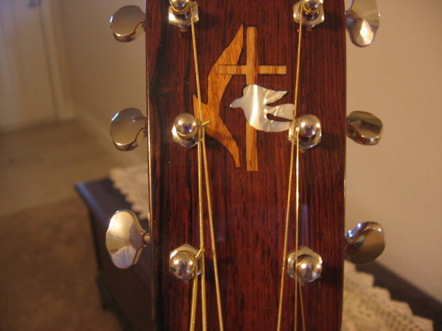

I like the headstock inlay also.

Superb first effort! Very nice. How was she bent? Did you have a booth for the Nitro? The finish looks awesome...

Fantastic job! Very clean execution for a first, and you tried some really difficult things like mitered purflings, inlay, and hide glue. Can't wait to see your next project

Excellent! I really like that volute!
Now I truly understand your dilema with the bridge.

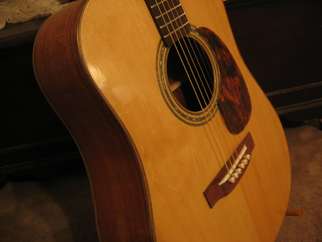

Without exception that is a great first guitar, certainly worthy of the time and effort required to replace the cracked madrose bridge with BRW as Mario suggest.

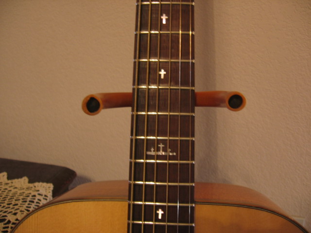

Great inlays too. You did your homework and made the guitar a complete success. Good JOB.

Very nice indeed Wes! Ive never seen Oak bindings, they look great!

Alain, I built a bending form for this one. Basic MDF covered in stainless, heat blanket and stainless shim stock cut for slats. I broke the first set of sides (which actually looked much better than these) and had to replace 'em. I confess, I didn't spray in a booth. I sprayed in my garage with a pedestal fan at the door drawing a draft. Don't yell at me, y'all! I felt comfortable with the concentrations (and wore a respirator), but I do intend to set up a dedicated spray room in my next shop. In fact, someone has offered to give me an old house to be moved which would be perfect - rooms already divided for rough work, clean/setup area, finishing room... Could me moved and set up cheaper than building one by far and already be wired, doors, windows, plumbing if I want it. I also built my owns jigs, forms, molds, binding jig, etc.
The entire thing was sprayed with a Preval. Actually worked pretty doggone good! The finish actually looked much better before I scratched it up doing the setup. Another thing I'll have - a dedicated, padded setup area. I did have a problem sanding through and had to reshoot a couple of areas. Even after the last finishing, there are still some area that need to be touched up. I'm almost afraid to touch it, seems like it gets worse every time! I'm still very pleased with the outcome.

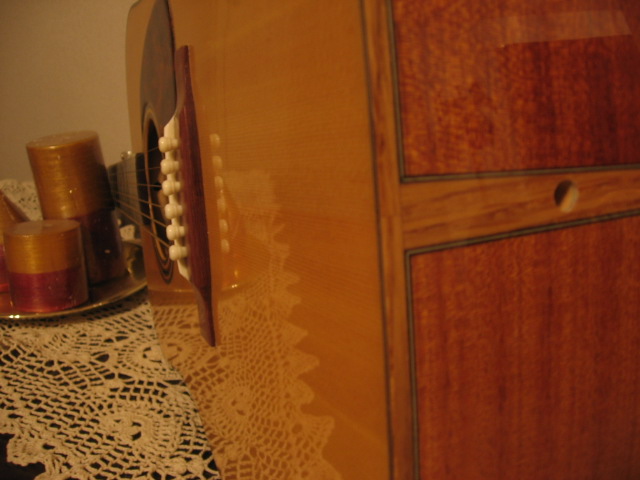

Kinda the same thing with the purfling. The miters, if I do say so myself in my super-humble opinion, were about as perfect as they could be. But, lesson learned (take note on this), make sure at least the ends to be mitered are close to level BEFORE you try to miter. Mine were proud and when I took them down level, some gaps showed up.
The "pseudo" - volute. Well, it is what it is. Once I started carving, that's what I wound up with. If fact, I got carried away carving the wings too far up the headstock and the tuner backs overhung the carved area. The tuners, you can see (OK, I know everbody will scrooollll back up now ) are actually shifted forward toward the end of the headstock to get a flat surface to attach.

Love your guitar. It is very stylish from the inlayed headstock to the beautiful end graft. You did one heck of a job.

A little bearclaw action, also showing the drop in/through saddle.
Back and endgraft showing my flubbed miter. It looked really good before I levelled it...promise!
Closeup of headstock. The flame actually had a lot more red before I sanded it. It looked really cool with a line up the middle and the right half kinda red.
12th fret inlay

And here you can see the bound fingerboard along with the still way-too-high action. As soon as I get up from here I'm going to take the saddle down quite a bit. Nut action and neck relief are almost perfect now.

Great job!! Love the headstock inlay! Keep up with the great work!

I also like the drain hole in the bottom so you can play in the rain. I've only seen that on top of the line guitars.

DreadLove! Really nice work, Wes. Now, Ron thinks that the end-graft hole is for drainage, but, of course, in truth it's a stealth sound-port--so the banjo player can hear you!
